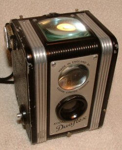

    I have managed to get an old 620 film on ebay. It's been exposed but I have no idea how old it is and have no desire to develop it (out of a morbid curiosity), so I investigated how it all fits together etc.
    It seems very straightforward and I've ordered a 120 film to give it a go.
    I'll see how it turns out, I suspect I may have to take the camera to bits and give it a right good clean. It's a Kodak Duoflex which has no focus or shutter speed control. I'll probably use it for one film then put it on a shelf for decoration, but it will take me back to when I was a child. (The camera is a lot older than me)
    Like this one:-
    Thanks
    Nick
