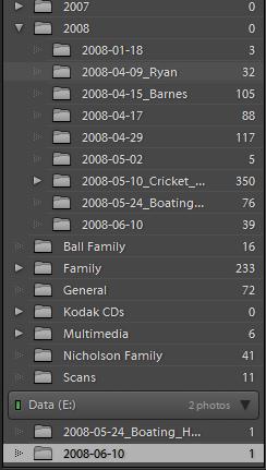

Select a JPG and 'Edit copy with Lightroom adjustments in CS3'. The file opens in CS3 OK. When saving it creates a TIF file with 'Edit' appended to the filename. The file gets saved to the same disk folder but does not show in the same catalogue folder nor is it stacked with original. Lightroom creates a new catalogue folder with the same name as the original.
You can 'synchronise folder' on the original catalogue folder and the new file will be imported into it's correct place. This anomaly also happens when opening RAW files.
